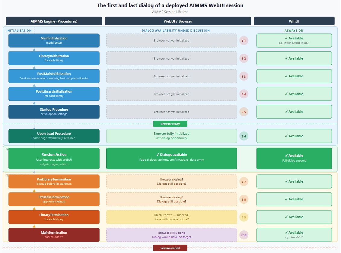

Lifecycle phases
_images/webui-session-lifecycle.png
The lifetime of a session goes through the following phases:
  1. AIMMS engine startup. The engine loads the project and executes MainInitialization. The WebUI library is not yet initialized and no browser is connected. The WebUI session is not active. Dialogs requested here cannot be shown.
  2. Post-initialization. PostMainInitialization is executed. On AIMMS Cloud this runs in the data session before the browser has necessarily finished connecting. Do not rely on an active WebUI session here.
  3. WebUI session active. The WebUI library is initialized and a browser tab has connected; the first page is loaded. The first model-side moment that is guaranteed to run inside an active WebUI session is the upon-load (page open) procedure of your home page: it is triggered by the browser loading that page, so a connected browser is present by definition. From this moment on, dialogs, side panels, notifications and page navigation work as expected. The session remains active for as long as at least one browser tab is connected.
  4. WebUI session ends. The session ends when the last browser tab is closed, the end user ends the session from the browser, the session times out, or the application is stopped. From this moment on, no dialog or page can be presented anymore.
  5. AIMMS engine shutdown. PreMainTermination and MainTermination are executed while the engine shuts down. The WebUI session has already ended (or is ending). Dialogs requested here cannot be shown. For example, a “Do you want to save your data?” dialog in MainTermination will never reach the end user.
