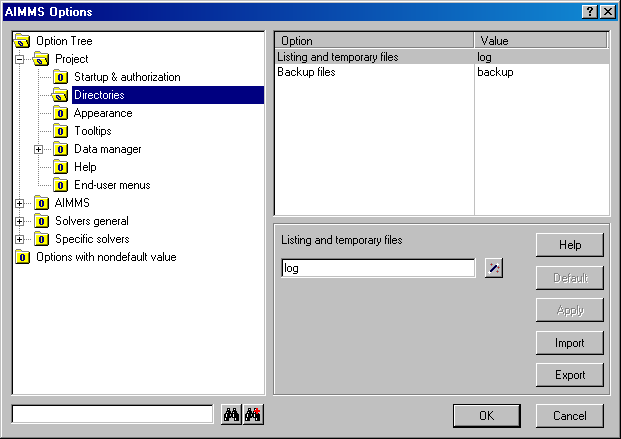

In the Options dialog box, an option tree lists all available AIMMS execution and solver options in a hierarchical fashion.
img_def_AIMMS_Options_dialog_bmp
At the left-hand side of the dialog box, you can select the option category. At the right-hand side, you can select an option. You can change the value of this option, set the option to its default or ask help about this option. You can also export the options to a file or import options settings from a file. In the left-hand side there is an extra section with options that have a non-default value. At the bottom there is a possibility to type the part of an option name and search on the string in the option tree.
