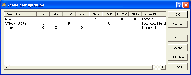

You can get an overview of the list of solvers currently known to your AIMMS system through the Solver Configuration dialog box. In this dialog box all available solvers are listed (in alphabetic order) along with the model types they can handle. A solver appears as a row and an ‘x’ is placed in the column of each model type that the solver can handle. A bold ‘X’ indicates that the solver is the default solver for the corresponding model type. Note that the Solver Configuration dialog box is a user resizable dialog box that gets its size from the previous time it had been opened.
img_def_Solver_configuration_32_bmp
The buttons on the right-hand side of the dialog box let you globally modify the solver configuration of your AIMMS system. Through these buttons you can perform tasks such as:
  • change the default solver for a particular type and
  • add or delete solvers

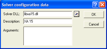

Clicking the Add button will open the Solver Configuration Datadialog box.
img_def_solver_configuration_data_32_bmp
