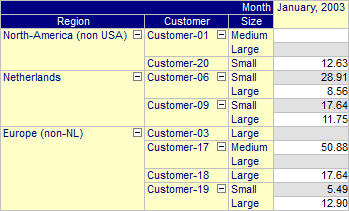

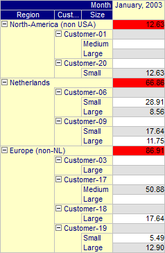

Layout
With this property you can control the layout mode for the row area. Two layout modes are available: ‘Column Mode’ (default) and ‘Indentation Mode’. In ‘Column Mode’, the row tree contains a single row for every leaf node in the tree. In ‘Indentation Mode’ the row tree contains a single row for every node in the tree (i.e. intermediate as well as leaf nodes). Although the row tree will contain more rows in ‘Indentation Mode’ (when compared to ‘Column Mode’), the total width of the row tree needed to display all element labels can be smaller since, in ‘Indentation Mode’, the element text of two labels on the same path are indented as illustrated in the images below.
Show First Aggregator at Parent
When the layout mode has been set to ‘Indentation Mode’, this property can be used to indicate that the extra row inserted should be used to display aggregator values (if present). The bottom most aggregator that has been inserted before the element list, will be displayed at this position. In this special case the aggregator text will not be displayed, as the row already shows the element text. The image below shows a pivot table for which a sum aggregator has been specified before the customer’s element lists.
