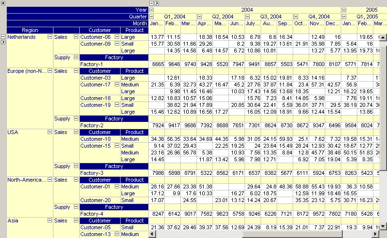

To understand why a certain movement is not allowed it is necessary to understand the difference between common and uncommon headers. Common headers are headers that correspond to indices present in the index domain of all identifiers in the pivot table. The special ‘Identifier’ and ‘Case’ are also common headers. All other indices are referred to as uncommon indices. Note that all indices are common when the pivot table only displays a single identifier.
The figure shows a pivot table with two identifiers, a 6-dimensional ‘Sales’ identifiers with index domain (customer, region, product, year, quarter,month) and a 5-dimensional ‘Supply’ identifier with index domain (factory, region, year, quarter, month). The ‘customer’, ‘product’ and ‘factory’ headers are the uncommon headers and appear as so-called subheaders in the pivot table.
