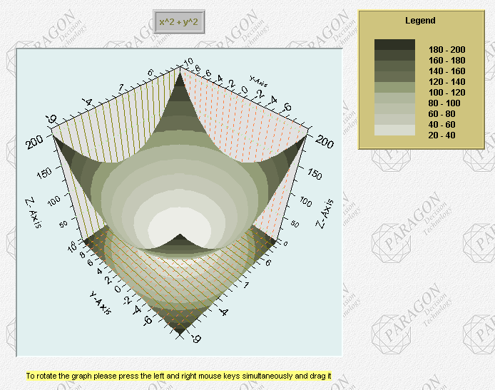

An example of a 3D chart is shown below.
img_def_3Dchart_BMP
