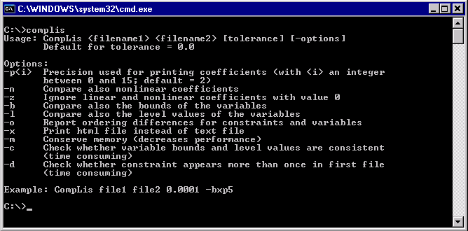

If you type ‘complis’ at the command prompt you will see something similar to the picture below.
img_def_cl2_bmp
The text printed summarizes how CompLis should be used and it gives a short description of the options that can be used. The arguments ‘filename1’ and ‘filename2’ are obligatory (unless the single file mode is used). If you use a .lis file then you do not have the write the .lis extension; for other extensions you have to write the full name of the file.
The optional argument ‘tolerance’ specifies the (absolute) tolerance that CompLis should use for comparing two coefficients, right hand side values, level values, etc. If possible, you should use the same number of significant digits used for numbers printed in constraint listings in both listing files. This is controlled by the AIMMS option Listing Number Precision .
The options that can be used for the optional argument ‘-options’ are described in more detail in the Options (normal mode) section. Note that the ‘-bxp5’ in the example means that the options ‘b’ (comparing variable values) and ‘x’ (HTML format) are set, and that the precision for printing coefficients is set to 5.
